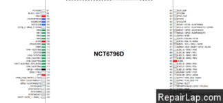

SLP_S3# is low on my SIO.
SLP_S5# is low on my SIO.
PCHVSB/SLP_S0# is high 3.3V
SLP_S4 is 5V which seems weird.
I might be mistaken here, first time i am learning about S-states and trying to meassure them!
Just realised i was using pinout from Nuvoton NCT6796D, but i have a NCT6798D and i cant find a datasheet for that chip.

check SUSCLK ON ec if it been recived or not .

Cant find out where i can check that, because its related to the PCH and i have no Boardview or shematic of the board.
on the ec it self .

My problem is that i only have a pinout for the NCT6796D, but i have a NCT6798D on my board and the piunout is different.
The NCT6796D has only these following pins:
SUSACK#
SUSWARN
SLP_SUS#
SLP_SUS_FET
SUSACK#
SUSWARN
SLP_SUS#
SLP_SUS_FET
SUSCLK or CLK_EC

No external link on this forum you can upload your picture directly to this post .

Just the ec right?
you shoud found if the SUSC and SUSb is been available on the NCT6796D if so than all the other signal will come . and the slp stat does't goes up to 3.3V
