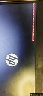

hp ProBook 430 g7 which files u upload its working fine but when i start the laptop display is too late and there one msg system is booting in manufacture program mode
can u fix it and upload again
Send a picture .
after copy this file laptop turn and goes off in 22 sec 4 time and display come
and internal keyboard stop to work
Bios can't stop your keyboard from working , try to use an external keyboard . and maybe you can use the last bios available on the official HP website .
